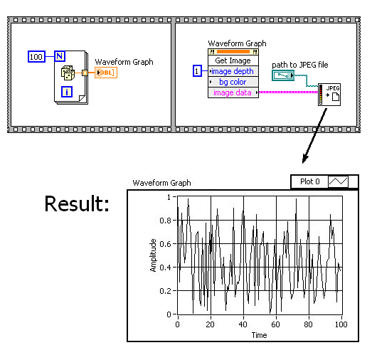

How do I programmatically send a report to a printer that include graphs that has only lines, and no solid areas ( to conserve ink)? I can do it from the menus if I set tools/options/printing/Color Grayscale to off. But it does not affect the report generator VI.
(2,571 Views)
Hi Mark,
All you have to do to create a ink-saving image of a Graph is to specify "1-bit" for the "Get Image" method that you can create by right-clicking the Graph indicator. Here is a small VI and the image created:
Have fun!
