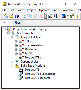

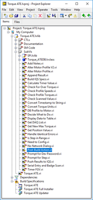

So I've recently started restructuring my projects to be like what the first image shows. It's so succinct and neat looking, and because everything is privately scoped, I can be sure that there are no cross dependencies between projects. Well that's all well and dandy until I realize that my Post-Build Action VI (second image) can't be privately scoped. Which really sucks. Ruins the neatness completely.

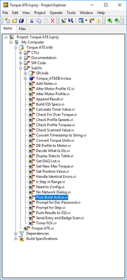

1. Change SubVIs Virtual Folder's access scope to Not Specified, keep all private except the PBAVI:

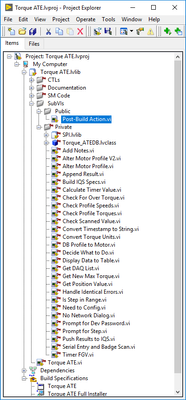

2. Make Public and Private Virtual Folders inside the SubVIs folder, with each sub folder scoped appropriately:

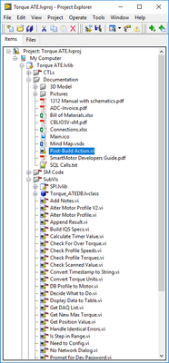

3. Change the Documentation Virtual Folder's access scope to Public (because what does privately scoping documentation do anyway, it just looked even neater with literally everything privately scoped) and add the PBAVI to it:

So I'd opt for number 2, but I have to ask, how exactly do you plan on using a library in which literally everything is privately scoped? Do you JUST use everything within the library, never intending any VI's at all to be reused as part of something else?
Regarding privately scoping the PBAVI, you can't do that, as that VI isn't called by the library itself- it's called by the App Builder, which is outside the library.
If you really wanted to, I suppose you could write a privately scoped Build VI that calls the App Builder. Doing that would let you use PBAVI's easily enough, but you'd lose the simplicity of doing it from the Project Explorer.
