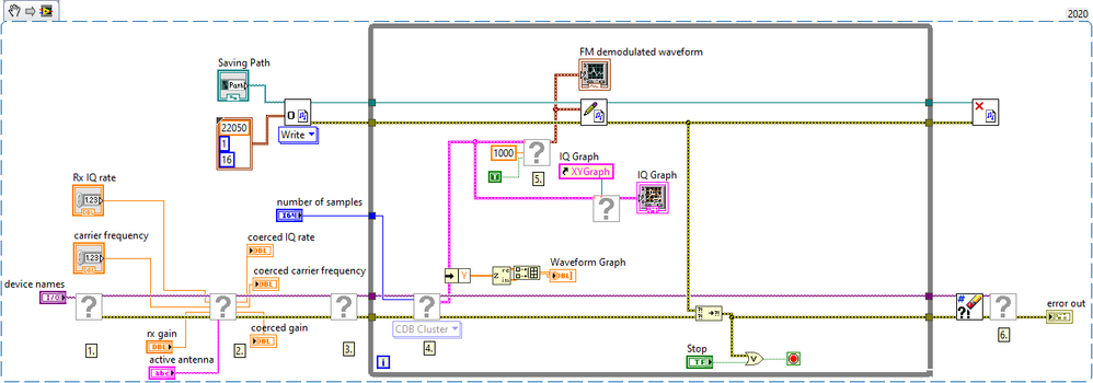

So, I have an FM receiver which receives demodulated data, I want to write that data to a .wav file but since it is in a while loop it rewrites with every sample of info.
Could you please help me out a bit?
I'm attaching the VI here,
Thank you.

When the file function overwrites existing data each iteration then you need to collect all the data in a waveform before saving to file…
How much data do you want to collect?
Maybe a different file format may work better/easier for you?

The VI you're using, Sound File Write Simple.vi, will overwrite the same file path, and doesn't append to the file. You'll need to create / open a sound file before the while loop, and then inside the loop write each waveform acquired from the FM receiver to the sound file.
Take a look at the example code in <LabVIEW>\examples\Graphics and Sound\Sound\Sound Input to File.vi to see how to use the sound file functions. The end result should be something like this (I don't have NI-USRP installed, hence the ? subVIs):

Hello, I want to capture a single song (ride of the valks) aprrox. 5mins. So .wav would be the best since I will be able to play it as well.
Could you please provide me with your idea of collecting all the data in a vi?

When you want to sample 5mins of sound data then my suggestion is not valid anymore: 5min*60s/min*44100Sample/s*2channels~=26.5MSamples. This needs ~212MB memory in total, which would be feasable, but isn't recommended because my appraoch would require constant memory handler actions…
Stick with the other suggestion you got!
