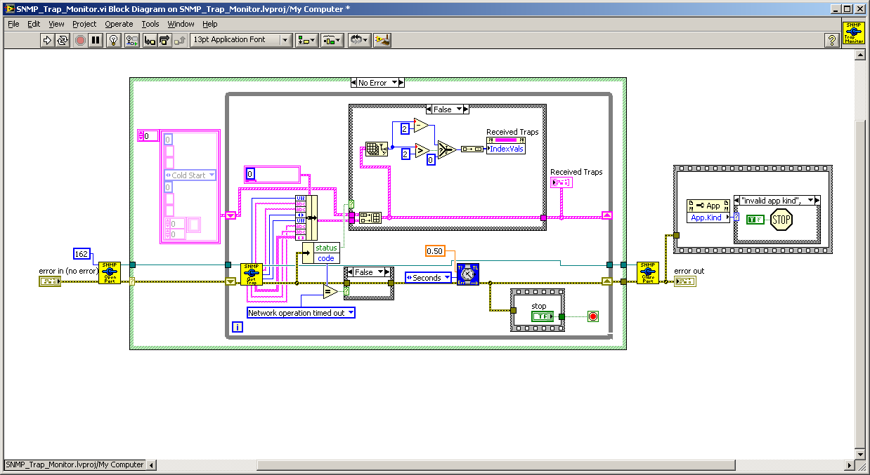

Here is a very basic Trap Monitor. The Trap VI is used to monitor the UDP port for SNMP traps. It will decode the data and return the parameters of a trap. (I should have used a cluster and if I update this library I probably will do that.) Do you have a specific question regarding the use of this VI?

UDP is not connection based so there is no address you specify when opening a refnum. And any UDP data packet your receive also gives you the address from where it originated. So you have to filter that address and see if it matches the address you are interested in and in that case do whatever you need to do with the package.

SNMP Traps are asynchronous events that are sent from an agent to either a specified IP address or are sent as broadcast packets. Traps are sent to UDP port 162. The example I included above creates a listener on port 162 and will receive all traps that are either broadcast or sent to the IP address of the PC. The example decodes that trap message. You will have to add code to filter out any traps that you are not interested in. The MIB definition of the UPS should specifiy which OIDs it uses for its traps. The MIB should also define what data is included in the traps.
Querying the device itself will require you to use the get request VIs from the library. You will need to know the IP address of the device you want to query and what OIDs you would like to retrieve. Again, the MIB for the devices you are trying to query should provide you with the deatils on the data they provide.
While these VIs could use some enhancements they all work quite well. I have been using them for at least 10 years.
What UPS are you trying to communicate with? Do you have the MIB for the device? If you post the MIB and let me know what data you are interested in I could tell you which OIDs you will need to use.
