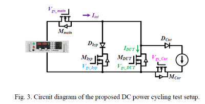

I have designed a power cycling test bench using cRIO-9022. Fig 3. below shows the circuit diagram and Fig 4. shows the timing diagram.
M_main, M_byp, M_DUT, and M_cur are the MOSFET switches that are turned ON and OFF using driving signals generated from NI-9402, with respective channel numbers and the associated MOSFETs shown below:

I am working on temperature cycling where I turn ON and OFF a set of SiC MOSFETs for cycling their junction temperature. This is being done with the help of procedure called 'Active Power Cycling'. Below is the circuit and timing diagram.
Here, M_DUT is the set of 4 resistors (3.3 ohm each) that are connected in series. (Please note that M_DUTs should be the series connected MOSFETs. However, for troubleshooting purposes, I am using the resistors for now. So, gate signal to M_DUT is not relevant for now). The main program with different states is written in the RT Scan interface (filename: Debug.vi). I am logging the voltage drop across each resistor using NI-9229 C-series module and the program is designed in RT Scan Interface using subVIs (Data_Logging_ON.vi and Data_Logging_OFF.vi). NI-9402 is used to drive the gate drivers of the MOSFETs (M_main, M_byp and M_Cur). This part of the code is written in the FPGA interface using subVI (filename: NI9402.vi).
The setup has 3 main states and I have explained them below:
'State 1': M_main and M_bypass: ON / M_DUT and M_Cur: OFF ---- In this state 500 mA (I_tot) passes through the 'Main' switch in forward direction. Out of 500 mA, around 488 mA passes through the M_byp and 12 mA (I_DUT) passes through the M_DUT. The voltage drop across each resistor in M_DUT should be around 0.04 V.
'State 2': M_main and M_DUT: ON / M_byp and M_Cur: OFF ---- In this state 500 mA (I_tot) passes through the 'Main' switch and 4 series connected resistors (named M_DUT in the diagram) in forward direction. The voltage drop across each resistor in M_DUT should be around 1.65 V.
'State 3': M_Cur: ON / M_main, M_byp, M_DUT: OFF ---- In this state 100 mA passes through the 'M_Cur' and 4 series connected resistors (M_DUT) in the reverse direction. The voltage drop across each resistor in M_DUT should be around -0.33 V. Please note that voltage should be negative as the current is flowing in the reverse direction.
