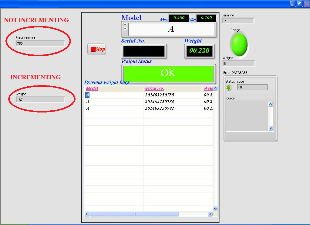

I now used 2 while loops but one of the while loop halts after some times after my application halts.
Here is also my application which I modified.  Let me know if I any modification is needed.

As I showed in my VI one loop is running and other stops, if any data appears then it starts running. Its woking on development PC not other PC, I genuinly think this is not a hardware problem becasue  number which is keep incrementing is actually a data which I am reading from COM port. I have COM PORT (9 pin) directly given to my other PC (where I am installing my app) motherboard. Infact in development PC I am using adaprt (RS232-USB). What you said is right regarding power management but here I am not using any adapter. This might possible that my scanner which is actually halting may have some power management setting. Let me check this settings.

Its ok friend. I had this doubt that this is feature, when I was using 1 while loop then it was making whole vi halt and now only one while loop is halting.
