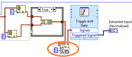

I think I'm doing something wrong or not understanding what you told me right. Look what I tried to do, but it did not work:

Hi rd,
you can manipulate each waveform individually using GetWaveformComponents and/or BuildWaveform.
The function you picked will not do what you need…

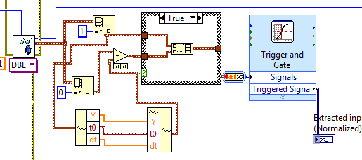

(4,307 Views)
I can not do it, it did not work.

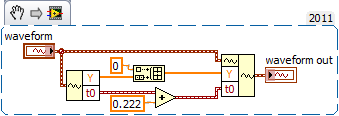

Hi rd,
as long as you only attach images we cannot debug or modify them using LabVIEW…
Both ways to manipulate waveforms I mentioned before are shown in this snippet:
