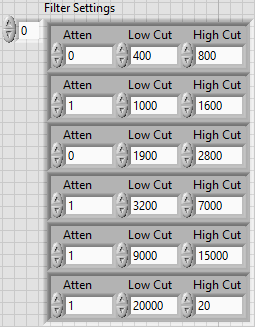

I built such a TypeDef (which I called "Filter Settings) that had three numeric parts -- Atten (which you called "Numérique", the default name, in French, for a "numeric"), Low Cut, and High Cut.  It is always a good idea to name your variables -- I called this "Atten" (to remind me of Attenuation, or a "dividing down" of something, as you use this as the divisor for your Waveform Array).  I then created an array of these clusters and populated them with the values I found on your Front Panel.  Here it is:
Several things to notice (besides how much neater and more organized this looks).  First, two Attens are 0, which means you are dividing by zero, usually a Bad Idea.  This organization makes it easy to see the various filter ranges, and to spot that possibly the final filter is mis-specified (looks like Low and High are backwards).  When you go to use it, you can wire this array into a For loop inside of which is a single Filter that gets called multiple times.

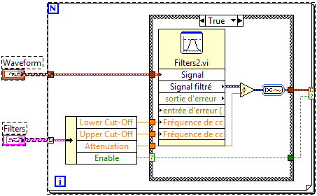

Finally, you completely missed the point of building the Array of Clusters in the first place.  The idea was to replace the six identical pieces of code with wires running all over the place with a single For Loop that receives the Array of Controls as its input and returns the Array of Signals as its output.
So I'm violating my own rule about posting Code, and not a Picture -- this is, indeed, a "picture" of code because if you want to use this, you need to do the (minor) work of creating this and seeing how/why it works.  Before doing this, I modified your (un-type-def'ed) Cluster by adding an Enable boolean (the Control on the Front Panel looks very similar to the Control I posted earlier, it just has a column of Enable switches).  Here's the code, comments to follow:
"Filters" is my Front Panel Array of Filters.  Note that the size of the Array (= number of Filters) appears nowhere -- it doesn't have to, as the input Array tunnel is "auto-indexing", running once for each array element (look at the picture of the tunnel -- it is an empty square with a pair of array brackets, [], inside it).  The top input is the Waveform wire that you get from the first element of the Wave output array.
When working with Clusters, you should (almost) always use "Unbundle by Name" and "Bundle by Name" -- it makes your code more self-documenting, and reduces the chances for Stupid Wiring Mistakes (though, believe me, they will still occur).  I use the Enable setting to decide whether or not to Filter (why waste time and CPU cycles if you are not using a Filter Bank?) -- the False case just wires the Enable and Waveform inputs to the corresponding Case Output tunnels.  I do the Attenuation division after the Filtering (it doesn't matter when you do it).  Because Dynamic Signals can be problematic, I convert the output of the Filter back to a simple Waveform.  Finally, if Enable is not True, we don't want to use this value, so the output Tunnel has been made a Conditional Tunnel -- if Enable is False, this component will not be used.
One thing that simplifying this code should show you is another strange feature of your code -- after doing all of this filtering using Filter Banks that you specify, you refilter the Merged Signal (or, in our case, the Array of Waveforms) with another 20-20K (a very wide bandwidth) Filter.  Why filter twice?  Each of your signals (presumably) is already filtered over a narrower bandwidth.  If you did want to do this, I'd do it first on the Waveform going into the Filter Bank (it would save you a significant amount of time, as you would only have to filter 1/(number of filters in your wavebank) signals).
Oops -- I didn't even notice that you do something even stranger -- you filter twice, using 20 as both Low and High Cut (what does this do?) and following it with using 20K the same way.  I really don't understand this, but now that I've simplified your code, I can begin to "see the forest for the trees" ...
I hope this is clearer than my previous post.  If you have any questions, don't hesitate to ask.
