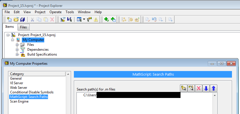

It looks like the only search path that's been defined for the application context is the default one:
If you want to auto-load a given path for this application space (not a "standalone" VI outside of a project), you'll want to define it there- right-click on the target (My Computer) in the project and select the Properties option to configure this.
The VI you provided is failing because it is looking in the application directory (\Project) rather than the file location (\Files), if the path is changed or your files are included in the "project" directory, then the node executes successfully.

I was able to get this to run by adding the "files" path to the application instance (which also fixes the development environment error), removing the path function, and rebuilding the executable.  Hope that helps!
