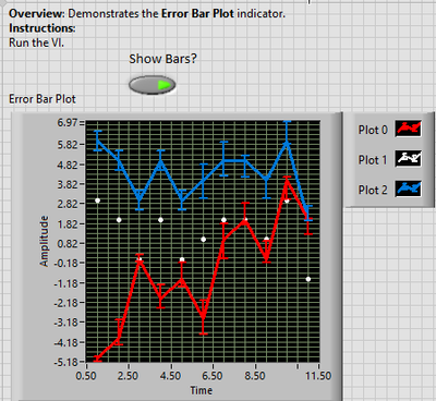

Bob Schor

Sorry, I'm confused.  When you say "Show Bars", I assume(d) you want to see the data + Error Bars, vertical lines going through the data points with little "hats" on their end to designate the interval corresponding to the chosen measure of variability.  Did you want to plot only vertical lines, but no "hats"?  You should be able to cook up a routine that simply plots a series of vertical lines that do this ...
Also, toggling the Boolean Control changes Plots 0 and 2 in identical fashion, and I thought your Original Post said only Plot 0 was affected -- more confusion on my part.
Bob Schor

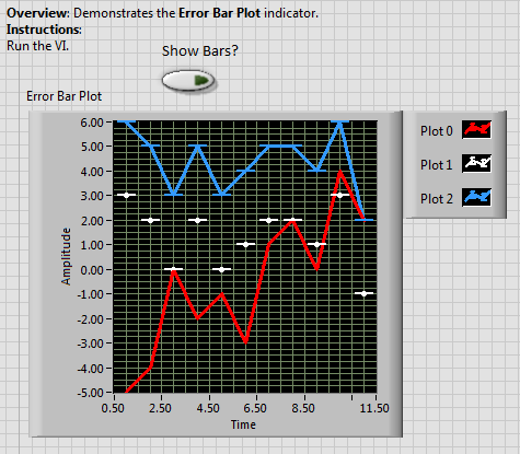

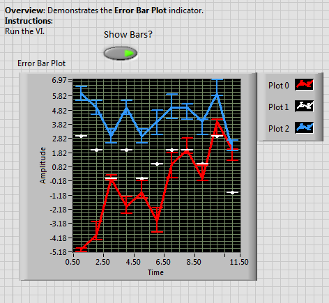

I'm trying to make the vertical bars AND hats disappear. You just are not looking close enough. When the Show Bars? boolean is false, the hats on the blue Plot2 collapse onto the data point, but remain visible, staying the same width.
I modified the demo vi, manually setting all the hats to size 4, so you can see clearly that they are still there on plots 1&2.
Also inserted screenshots, should have done that before:
