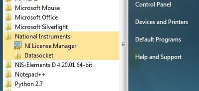

I installed Labview2013 64-bit on my desktop from here https://decibel.ni.com/content/message/58410#58410 .The installation was successfully.
But I don't see the NI labview13 in my programmes as shown in the attched image.
Can someone help me out in figuring out the problem with this.

If LV runs correctly, you can create the shortcut yourself.

The link you provided is for the 32 bit student edition. What exactly did you install?? How big was the download?

You can use NI MAX to list installed software. If MAX isn't installed, selecting National Instruments Software in "Uninstall a program" (Control Panel) and pressing "Uninstall/Change" will also give you a list of the installed NI software.
If your software is not listed in any of the above steps you will have to install the software again.
