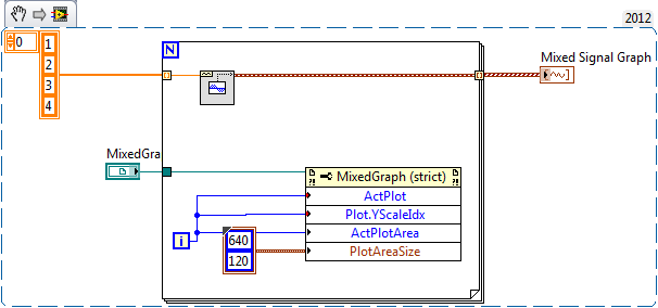

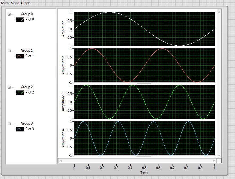

One option that springs to mind is the mixed signal graph. You don't actually have to have mixed signals, but it's handy to fit multiple plots on a single control and be able to plot them in a stacked manner (or displaying one at a time).
Here's an example:
I generate four sine waves, each with different frequencies. I send the array of waveforms to a Mixed Graph, having created four plot areas in the control (alas, not programmatically, similarly to cursors). I assign each plot to a different plot area, then set the size so they're nice and equal. Voila:

Extending that, if I want to toggle visibility, I can use the Plot.Visible? property for the Mixed Signal Graph. Similarly to the Plot.YScaleIdx property, you merely wire the active plot to it and a boolean.
