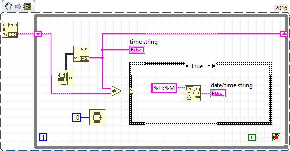

Here is some example code using the time section of the functions. The displayed times should be identical, but they are not.
(3,570 Views)
Both functions have a timestamp input, so get that once and wire to both.
(3,532 Views)
That's interesting. Wiring the same timestamp to both does indeed solve the problem. The routine for writing the file I am using is actually in a sub VI so I would have to wirethe timestamp all the way through.

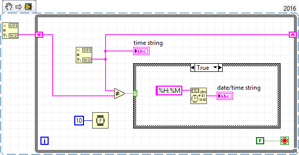

Interestingly this also cures the problem:
Actually wiring the timestamp to the "Get Date/Time String" function rather than letting it default to the current timestamp.
