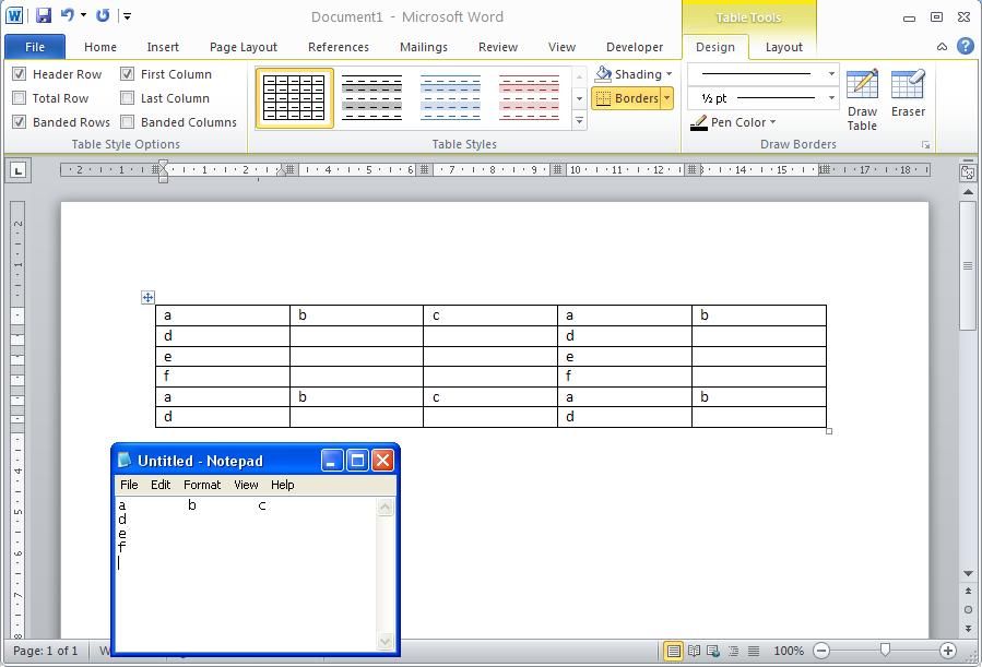

Hi all
I stumbled into this problem a couple of days ago. After some experiments I found that the problem is that Word 2010 treats cell separators while pasting table contents in a different way than before. The report generation toolkit uses line feed (LF, \n) to separate both columns and rows, filling one cell at a time, from left to right, and then continuing with the next row. However, Word 2010 expects tab (\t) to separate each column and then a LF to continue on the next row, and then fills the selected table area with this sequence.
I have not found out how to insert a new line or a tab within a cell.
Try this by opening a  Notepad a create a table with different separators and copy it, create a Word document with a table, select an area of the table and paste. The result may look like the picture below.
I've attached two toolkit VIs modified with the updated separators.
Best regards
Michael
