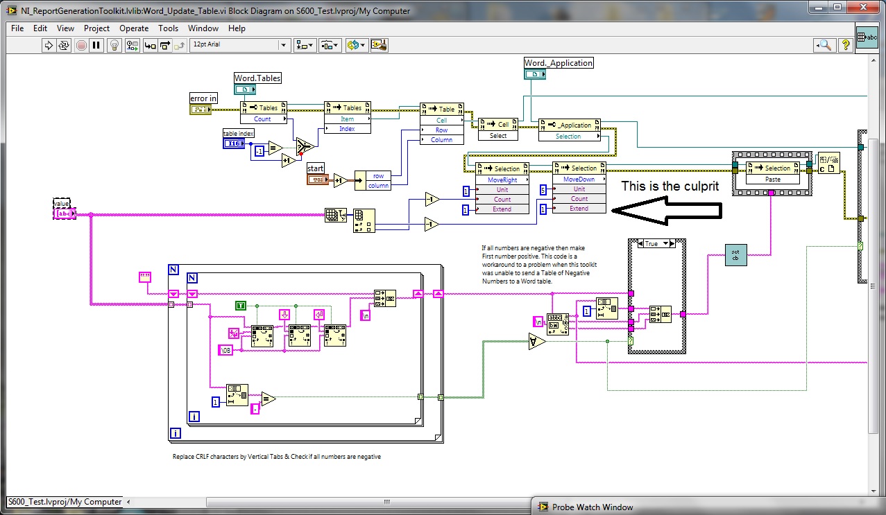

I have LabView 2012 and MS Office 2007 and I have the exact same problem as you do.  I think I found the culprit and fixed it.  I rewrote that VI for my application.  It's a sub vi of the vi you have in your picture.  It's in the NI "Word_Update_Table.VI".  If you tell it to move down 60 counts it will only move down 33 counts (Why? I don't have a clue).  I fixed it by sticking it in while loop and reading the MoveDown value subtracting it from the intended move down counts until it hits zero.
This is what I did to fix it.

Rich - two things I see that can be removed:
  • Not sure why there is a Flat Sequence Structure around the Paste Command. You don't need it because your enforcing dataflow.
  • Why is there a string wire going to the same Flat Sequence Structure when nothing is being wired to it? I'd remove that wire.

Eric,
I didn't write this.  It's the VI in the NI Report Generation ToolKit.  I was just pointing to the problem and I re-wrote this entire VI for my purposes so I didn;t post it.
I think think the reason for the flat sequence is to wait for the information to be on the clipboard.  The wire that goes to the flat sequence, but does not go anywhere, ensures the PASTE will not execute until after the information has been pasted to the clip board using that green VI that says Set CB.  It's a locked VI so I don't know what it does.
I did notice I made a mistake in what I did post, I forgot to exit the loop on an error.

Gotcha. I thought that the first image was your code and not the WordUpdateTable VI.
