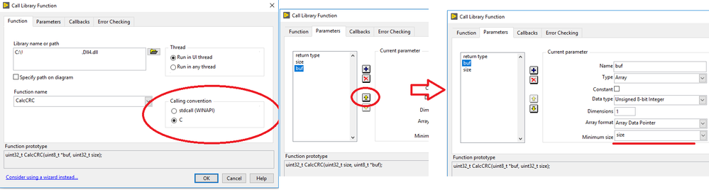

Hi milan,
Thanks for the code.
As cordm pointed out, the argument order was switched, and the calling convention was wrong.
Correctly just the first of these issues still produces a crash, but fixing both gives you a working VI.
I attached the example VI you gave, saved back to 2015.
You'll see the changes to the call here:
I also set the minimum size to "size", but this shouldn't be necessary so long as you're careful with the sizes of your array in LabVIEW and C(++). Essentially it ensures that if you pass an array with fewer than "size" elements, it will add elements to make sure that the array passed is actually large enough (i.e. "size" elements long).
Edit: I see looking at my image, that I didn't change the datatype of size. If you use an unsigned char in C, you should use a U8 in LabVIEW (not the U32 it currently has configured).
