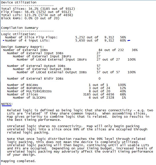

Hi, I'm working on project involves implementing on Xilinx Spartan 3E FPGA. I've completed the design, compiled it, then tested it and everything is OK. When I started writing the final results to my boss I encountered unusual problem. The percentage of LUT consumed by the design is 123% (5734 out of 4656). How is that possible? Again everything is working fine but how come the FPGA compiler reports that 123% of the LUT is used ?! Where did (5734-4656 =  1078) LUT come from?. Compilation report is attached. Thanks in advance.

This was reported to R&D (# 177016) for further investigation.  The report parser switches the numbers for LUTs and SLICEs.  The Xilinx log should show the actual usage and it will be less than 100%.  The bitfile is still valid and the design will actually fit unless the report specifically says that the compilation failed.

Due to a problem the compilation report parser, the summary displays 123%. As shown in the above picture, the actual LUT utilization is at 60%. This value should be consistent with the Xflow.log file generated by the Xlinx compiler. You may find the detailed Xflow.log file in the following location, for verification:
C:\NIFPGA[Version]\srvrTmp\localhost\[Your Bitfile Compilation]
