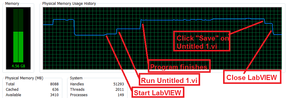

"Memory2.PNG" depicts, using Task Manager, how memory usage changes on different events. Running Untitled 1.vi causes an immediate jump that stays constant till the end of the program upon which is a second, huge jump! Then if I hit "Save" on Untitled 1.vi (at any point) after the program has stopped running, some of the memory seems to be deallocated. Finally, only after complete closing LabVIEW entirely, is the remainder of the memory usage freed.

Usually JPG compresses images with a ratio of ~10: this means those 45MB will uncompress to ~450MB in memory.
Your 3rd image shows the VI is using ~670MB of ram which seems reasonable…
LabVIEW will handle memory allocations on its own. It will keep memory buffers as long as (possibly) needed.
It will free memory when you flush VIs from memory…

But why does the memory jump at the end of the program?
Because the data in the shift register is copied to the "Slider" indicator.
Each indicator keeps its own copy of the data needing also memory for that copy…
