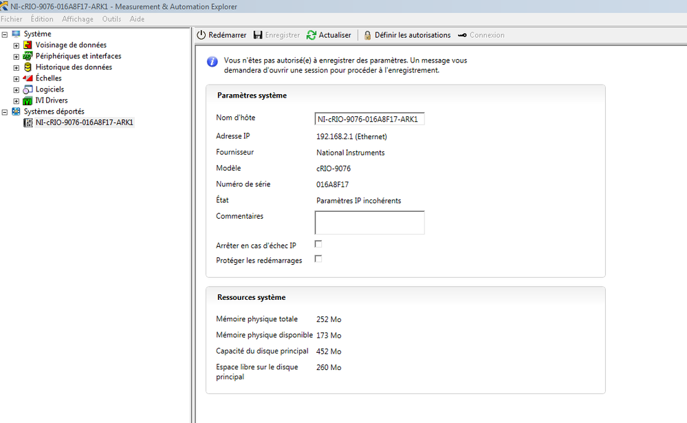

I have some problems with my cRIO 9076,
I have this message in the MAX : see the picture

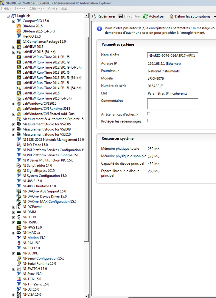

I think that I have all software intalled : see the picture
And when I create a project and add target device (cRIO) on my project, it like in this picture : see attached.
Thanks in advance.

The cRIO is not on the same subnet as your PC.
The cRIO needs to have a IP in the same subnet as your PC is has.
(4,627 Views)

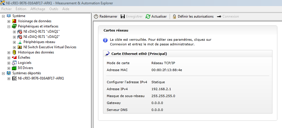

Thanks for your replies.
I try to change the IP adress of the cRIO, but I had this message :
"the target is locked. to edit these settings, click on login and enter the administrator password."
 the problem is that the login button is grayed. The screenshot is below
(4,607 Views)
Accepted by topic author Fred19ni
Change the IP Address on your computer to be on the same subnet of the cRIO.  You should then be able to log in and set the IP Address to whatever you want.  After the cRIO reboot, you can change your computer's IP settings back to what it was.
