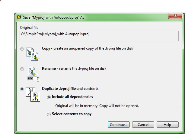

For Copying any LabVIEW project (.lvproj), you can not simply copy and paste the folder.
we have to do the below step:
File >> Save As.. and select the option Duplicate .lvproj file ( includeing all the dependencies) then only the project duplicate in to the other folder.
Note: if any conflicts in the project Save As option will not Enable.
another issues while building the copied Folder Build Specification EXE Paths are different due to this you have to add Startup VIs and Dynamic VIs Manually.
see the attachment for reference and copy in the C Drive and Try it.
