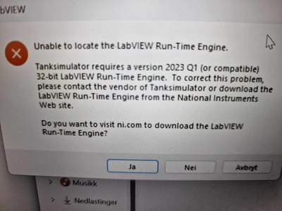

I havecreeated an executable file of my VI and want to run iton a PC without LabVIW in stalled.  For this PCV (withput LabVIEW) I ahjave installed LabEW RunTime.  But when I Run th executable  I got this error:

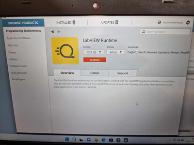

When I open the package Manager, I get the following:
So, LV Runtime is installed.  But I have no  idea on what to do.  Any suggestions?

Problem solved. I had installed 64-bit version, I needed 32-bit version.
