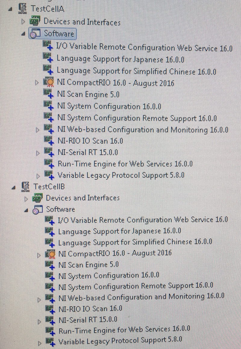

I have two similar cRIO (NI 9148) running NI Real-Time 6.3, and the same firmware version. I also have a host computer (Win 7, LabVIEW 2016). The two cRIO have the same software installed.
(sorry for camera screenshots)

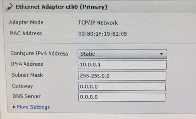

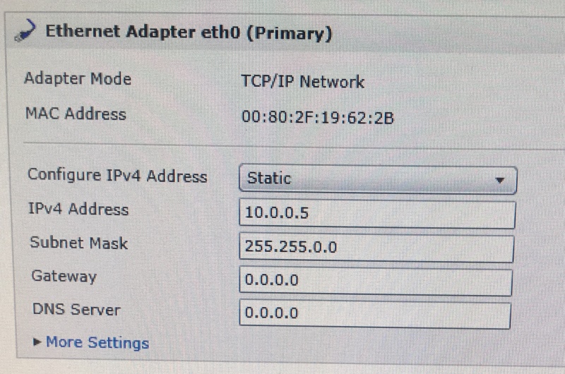

The cRIOs and host computer is connected to a switch, and the IP-adresses are fixed (10.0.0.4, 10.0.0.5, 10.0.0.6). Gateway and DNS is set to 0.0.0.0

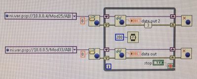

I create a simple test to see this:
The top shared variable will Open without error, but on the first read I get error 66209: Failed to initialize a deployed variable at system startup.

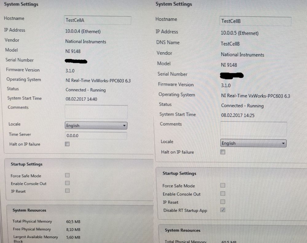

Here is a screenshot from MAX:
Notice that the working cRIO has a field called "DNS name". What is this, and why would one of the cRIO have it? Also, there is a difference under Startup Settings, where one has the option "Disable RT Startup App".

I just wanted to follow up on this, since the problem was solved.
I suspect that some network settings was corrupted, and remained from when the cRIOs was in a different network.
I formatted the cRIO, making sure to not keep network settings, and installed software again.
I noticed now that they appear similar, both showing DNS name, and no more problems.
