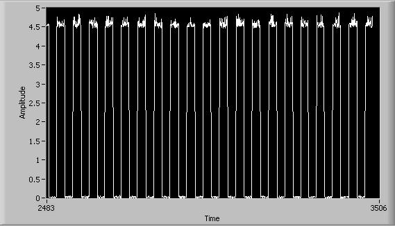

this is my output by waveform chart ...

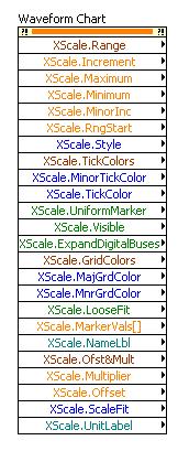

and this is property node of x scale of wave form chart ...
which section i have select ?

You want the x-scal multiplier.
Is your chart in seconds or points? If it is in points, you do not have enough refinement on your sampel. Are you sure that you are using a chart form or a graph? They do work different.
