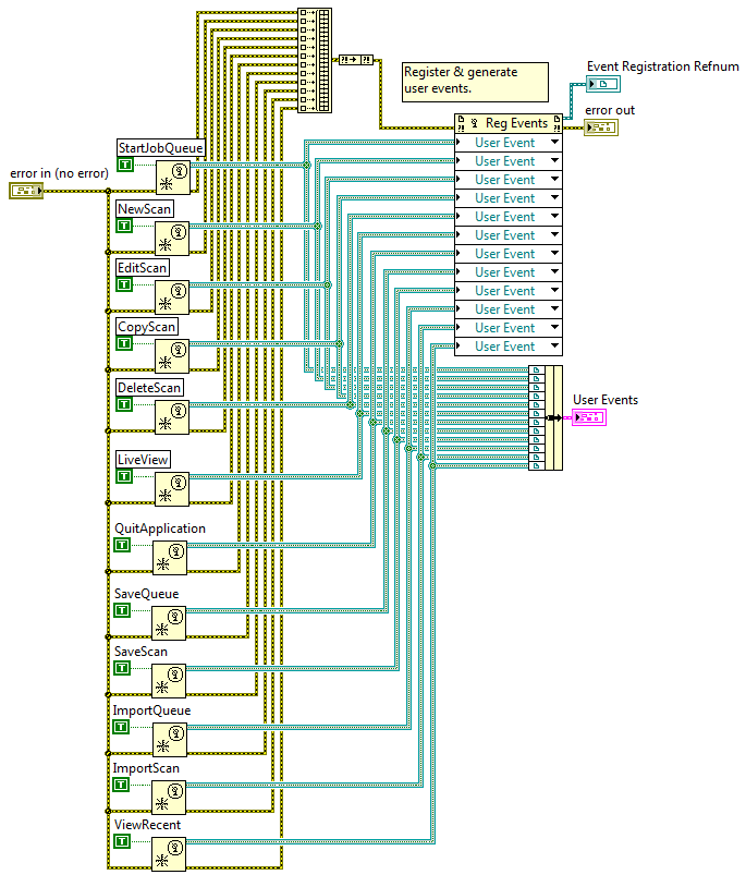

I like dynamic events in GUIs as a way of reusing code. But this can lead to registering a lot of dynamic events. To handle this, I often make a subVI that registers them for me. A typical one looks something like this:
Then I utilize it something like so...

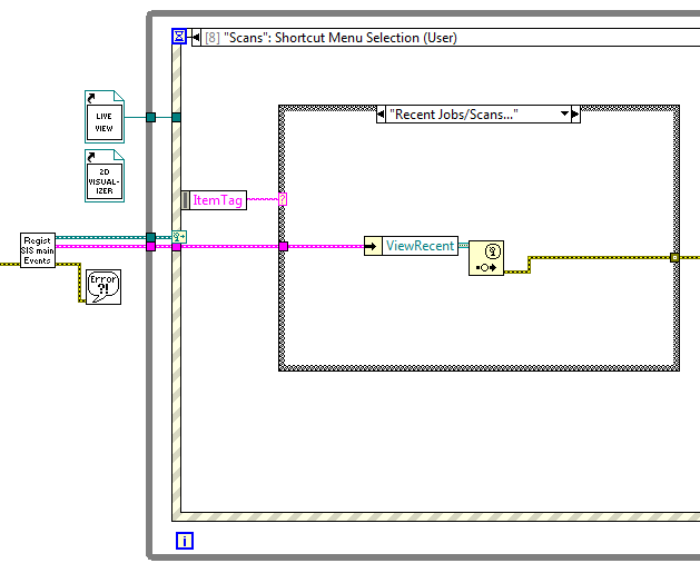

The first time I do it, this works really splendidly and keeps my code (relatively) trim. The problem I've run into on a couple occasions is editing the subVI. Suppose I add a new event. Now my "Event Registration refnum" and "User Events" cluster outputs are broken. No problem: delete those, create new ones, link them to the output terminals. Fine. Now go into the caller. Maybe I've again got to clear out some junk and re-wire here and there due to the type defs. Cool, done. As far as the block diagram goes, everything will look OK at this point; there are no broken wires. However, there are still pesky errors saying "Generate User Event: Contains unwired or bad terminal".
This is obviously some kind of hidden type def conflict. I will typically go through the whole block diagram ripping out wires, nodes, Generate User Event VIs, event loops, cluster unbundlers, the works. Then I code it all back in by hand. Still that gray arrow. I'll mass compile it once or twice. Still a no-go. Make a new VI and copy the code in there. Same problem.

Edit: I just remembered once similar thing happened just check the unbundling before the Generate User event which would have become blank, so manually select it and it should be gone.
Reedit: I recreated and noticed :Where is event data connected to Generate user event?

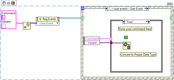

No idea how to solve your particular problem, but I can suggest the following. Use a User Event that is a cluster containing a Variant and Command. Rather than having multiple separate User Events, you have one User Event whose command you then parse.

The error is because the event data terminal is left unconnected at Generate user event which is Terminal of type Required : https://zone.ni.com/reference/en-XX/help/371361H-01/glang/generate_user_event/

Thanks, uday. Nice eye. Indeed, I do have to go through and patch up old connections due to the new type defs, and in the process I must have wiped out the event data. This was overlooked, because the event data is not at all important to how the events are being used.
Then there is the more philosophical question of why that terminal is required at all. ??? Oh well.
