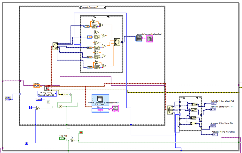

I am using build table express VI to log data and then to write it in file. I want to switch between manual command (Step signal) and sine wave command whenever I want during a session and at the end of session I wish to plot all the command signals and feedback signals in a single plot in the order and magnitude as they were given. That is why i am appending the data in a single file. However, when I use manual command for the first time to give let's say three command signals the data is logged properly after pressing 'save data' I also press 'clear data' after saving the data. Then I switch to sine wave it also logs the data properly. At this point if i press plot results the are plotted as I wish. After that I switch to manual command and when I press the 'send command' signal i see that table is not cleared and it remembers the old data as well so I see four data entries in the table while I was expecting to see only one.

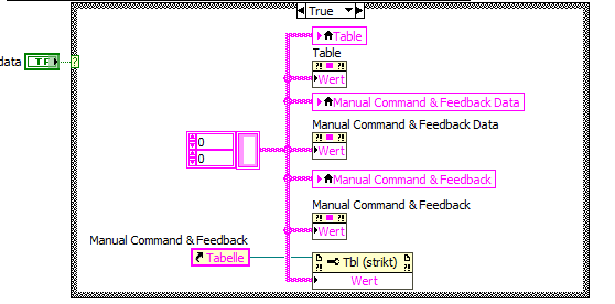

I have used the "Reinitialize to default value" option already that is of no use because the data temporarily goes but when I write new data the previous data also comes back. I tried to use the reset option of the table as well but since the tables are built in the case structure elsewhere so the clear data button does not serve the pupose even if it is attached to the reset input of table vi. So i tried to use local variables and "Value" property node of tables but that is of no use too.
Please help I am attaching the VI and screen shots as well which show that step signal data is appended with the first three signals while it should not be like that. I wished to get a plot in which there were three step signals before and two step signals after the sine wave.

Beside all those DDT wires: all the BuildTable ExpressVIs are set to NOT clear the data.
Other problem: each instance of the BuildTable ExpressVI will create its own buffer: when you try to fill your table from two different instances they will not know the buffer of each other!

Why do you need to write to a local variable AND a property node of the very same FP element in the same place?
For "Manual Command & Feedback" you even use 3 ways in parallel… 😞
"are you sure you really need to convert nice waveforms to DDT wires to fulfill your task?"
The answer is yes i really am sure. You see that I am using two tables "Manual command and feedback data" and "Manual command and feedback". The first one stores the complete samples i.e. 1000 samples per second and the second table is for presentation to user who only wants to see what command was given and what feedback was acquired so i show the user only one sample after taking mean of the data acquired.
I appologize for that 🙂 but you see I was quite frustrated because nothing was working for me when i was trying to reset the tables so I thought of trying all the methods I know to reset the tables and get what I want.

See the attachment: I made some "subtle" changes to your measurement loop and the filepath creation.
That's not the point.
The point is: you don't need DDT wires to create your table content! It will be much easier using the waveform array coming from DAQmxRead! (See attachment: replacing that part of those ExpressVIs and DDT wires reduces VI size by 50%.)
