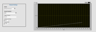

Hello there,
I spent some time debugging the program and managed to make some progress. First, I discovered that I had missed a wire. Second, I noticed that the functions responsible for sampling from the analog channels—channel 1 and channel 2—were acquiring both signals and indexing them into the same waveform data. I was able to separate each channel and obtained the following results:
This makes sense because those are the waves I generated.

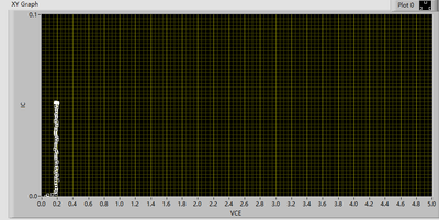

Now, I see that the issue lies in how I plot the samples. Since I’m overwriting the XY plot each time, I’m only displaying the last group of data. For example, I can see this:
For the first loops
Some loops later
Finally

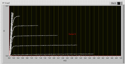

Hi all,
I finally got it:
But there i still have some trouble when changing with the plotting, if i change the plot type lining the points into a curve:
So now Im trying to acces the array data that makes this plot, is there a way to acces it?
Wen
(557 Views)

Hi Wens,
Two options to avoid those interpolation liines between the curves:
  • create separate plots for each curve
  • separate the data of each curve with a NaN point, when you put them all into one plot. NaN samples will not be plotted in the graph…
(547 Views)
Hi GerdW,
Thank you for your help, now it works as I want.
