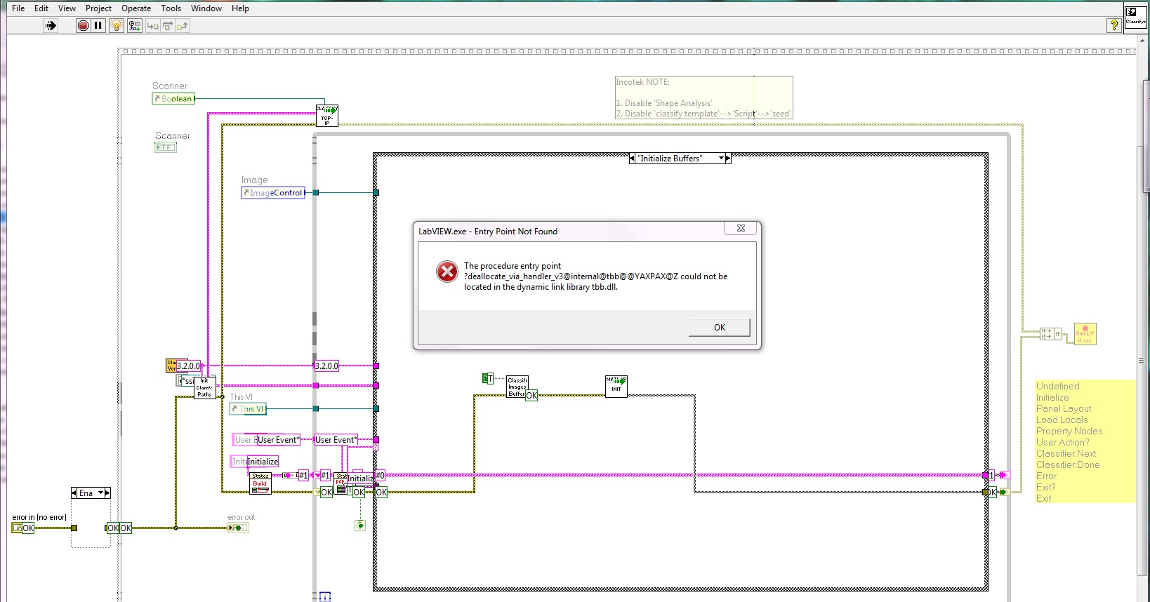

I have a Matlab compiled code with the C++ wrapper. Before Labview can use it, it has to initialize the Matlab Runtime. So I have a VI called 'Matlab Init' to do this, but when I put the init VI into my code, it pops a 'Procedure Entry Point' error, as shown below.

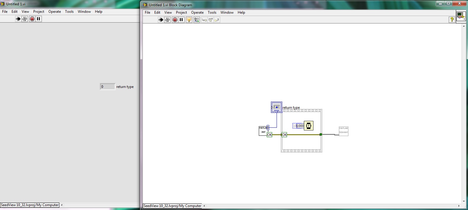

This code contains nested structures and other complicated initialization. I mention this because when I put the 'Matlab init' VI in a simpler VI, shown below, it works fine.
I am totally lost here. What caused the error in the first case? Is it because of some conflicts between the Matlab init and some LabVIEW functions? Does that error tell where it goes wrong? Desperately needs help PLZ.

The issue here is that MATLAB and our vision software both use a DLL called tbb.dll. Unfortunately our Vision software uses version 2.0 and MATLAB has migrated to newer versions. The problem comes from the DLL already being open in memory from our vision software and the MATLAB run time engine trying to use that same DLL which is unfortunately the wrong version.
It looks like a couple of customers were able to get past it in this forum:
http://forums.ni.com/t5/LabVIEW/tbb-dll-entrypoint-not-found/td-p/2269056
It appears that a possible solution would be to replace tbb.dll in the system folder with the tbb.dll that is installed with MATLAB. Although that would potentially break a lot of functionality of our Vision software. So, I would suggest keeping a back up incase you need to revert.
