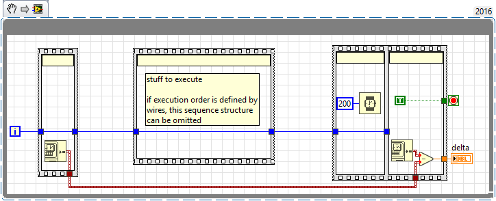

your time loggings and wait are not defined when they will run
here is an example to define exactly when these will be run
