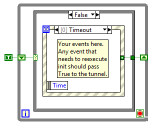

crossrulz, I have been trying to understand more about your suggestion. I have attached an image I found in the ni forums to understand and see if that is what you mean.
Message 9 of 13
(5,913 Views)
EventReinit
I do not know where you got that image from but with no timeout value wired it will never timeout.
