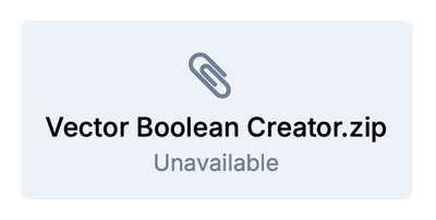

Unfortunately, on LAVAG, your code is
Can you repost it?
Can you repost it?
I can access it and download it. Are you logged in on LavaG?
Can you repost it?
Oops.  That was the problem.  I wasn't logged in (normally login is auto, so I don't think about it).
