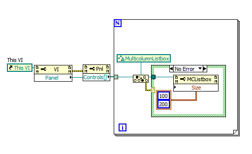

Your immediate problem is that changing the size of a control is only available through specific (as opposed to generic) property nodes.  Use the "to more specific" function from the App Control palette to cast the reference to the type you want.  If the generic reference did not refer to that type of reference, it will return an error.
here's code that changes all of the MCLs on the FP to 100x200px
since you say you know which controls you want to change, you can do it from created references, too.
... so If like me you have a cluster of references from the front panel already this should not be an issue. Instead of turning the cluster into an array, I should just work on the cluster as it is and put it through a state machine unbundling and updating each element as I go.
Brilliant. Thanks blawson

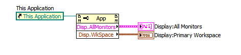

and for an extra tidbit, check out these properties:
 the top one gives you the resolution of each monitor on the system (mine shows 1680x1050) the bottom one gives you the workspace rectangle of the main monitor (and mine shows (0,1680),(0,990) which shows that the last 60 pixels there at the bottom are taskbar)
These should be useful for checking what the available space is for dynamically sizing things.

I'm using the Wkspace property to give me the size and as soon as I find I'm bigger or equal to the current resolution I'm checking for, I set the screen to that size.
