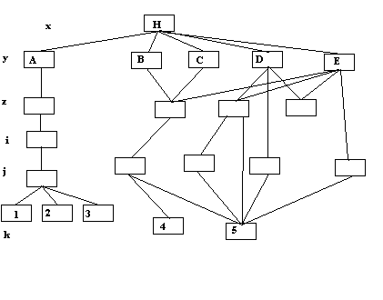

It's cleanup time in my world, and boy are things a mess (as you can see.)  I have inherited a large program from a previous person, and now that I have finished my addition, I'd like to update the names and descriptions of files programatically.  The problem is that the guy before me didn't exactly name or describe any of the files in an intuitively obvious way.  I'd like to update this and keep track of it using an external, generic vi that simply pulls from a reference to the host.
Let me explain.
Some things to note:  1, 2, and 3 are only dependant on A and are all of level k in the hirearchy.  4 is level k as well, but is dependant on B, C, and E.  5 is dependant on B, C, D, and E

The actual naming structure is in the works, but from my crude, crude example I hope you can probably see about the direction I'm headed in.  I'm pretty confident in my ability to do most of this, but there's two major snags.
-Can I obtain the detailed hierarchy to DO such calculations with nothing but a VI reference to its host?  Can I obtain references VIA filename?  I could always simply save the renamed files in a subdirectory.  I guess also using the "List Dependant Files" recursively could work, even that would not account for tier-skipping.  Plus, don't believe that it checks static VI references when you do it that way either.
-Is there a way to actually update references to the respective callers such that I don't need to Browse for every file whose name has changed?
Any input to improving the process or fixes for my snags would help immensely and be greatly appreciated.  I'm just starting to use VI referencing, so it may be a lot easier than I thought, I just don't know how.
Thanks Again,
~Andrew
Edit: Also, I WISH my program had that few files.  It has hundreds, most of which are poorly named and incredibly redundant.  4 and 5 in the example above may do the EXACT same thing.  So you can kind of see how A is mine, and the rest is everything I haven't cleaned up yet.  But I'd hate to clean up B, and screw up C, D, and E due to codependancy.  That sort of thing.  So, yeah.  That's why it's worth pursuing a programmatic solution.  It could take weeks to do by hand.
