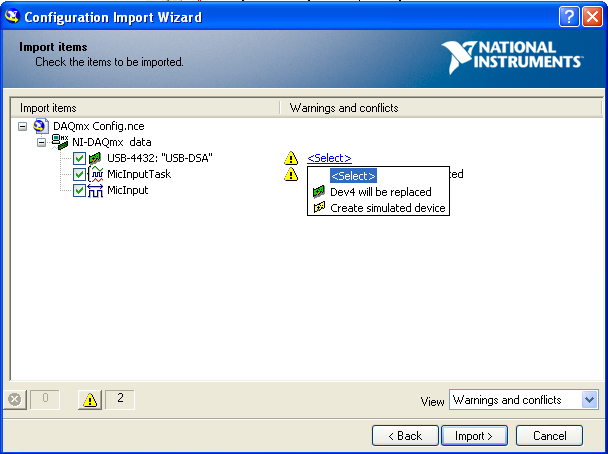

Which I assume is because user input is required to select which device to use. If I were to manually import the file in MAX, I would be met with the following dialog:
So, it would seem that the programmatic import will not work because it requires user input. But, since the VI is password-protected, I can't even dig in to add dialogs or address the problem in any way.
