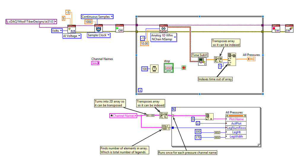

I am struggling to program chart legends and I am hoping to get some help. My code is simulating a NI9205 with NIMAX and DAQmx.  I am trying to programmatically update the legends by the user specifying the channel names.
I am having two problems
  • I can’t get the unused channels to disappear on the legend. I only want the legend to display channel names specified in the “Channel Names” Array. Reading online this seems to be a bug in LabVIEW. Any idea how to get around it?

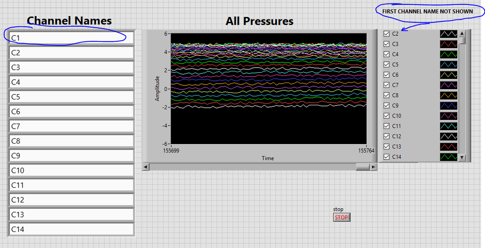

  • I can’t get the first channel name to be displayed on the legend. I clicked the Execution Highlighting (light bulb). It shows the first channel name being indexed; however, even though it enters the property node the channel name is not displayed on the chart. This has been bothering me for hours, and I don’t know what I am doing wrong. Attached are my codes.
ANY INFORMATION WOULD BE APPRECIATED!

Hi Kurtz,
I can’t get the first channel name to be displayed on the legend. … I don’t know what I am doing wrong.
You did wrong at the chart's property node:
first you set the plot name, then you set the active plot. You need to do that the other way around: first define the active plot, then change it's properties!
(4,385 Views)
Wow... well that did the trick. It works now thank you very much.

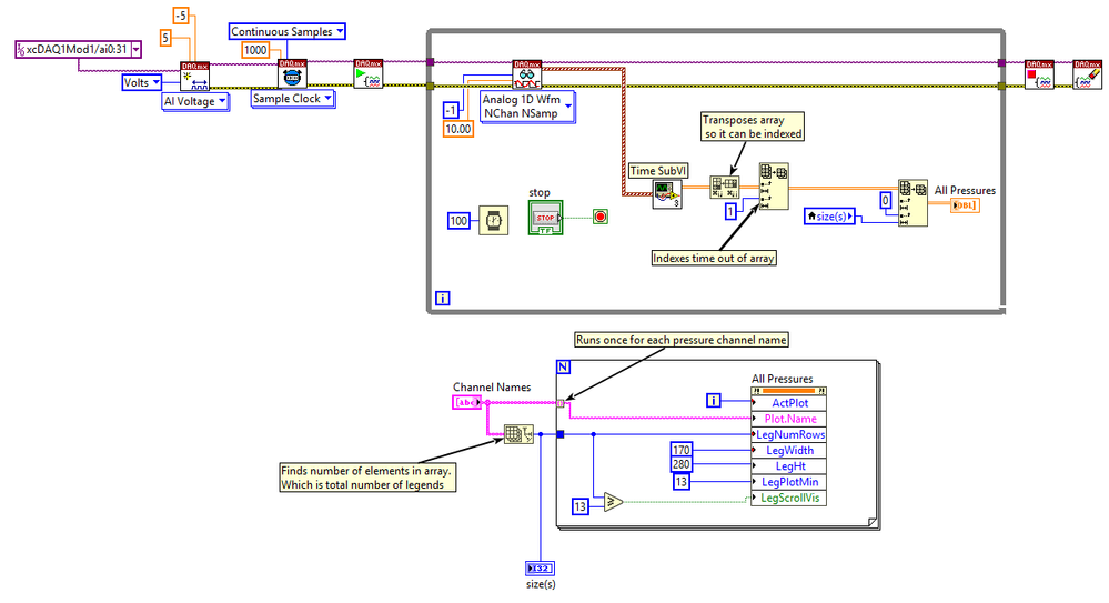

Do you have any idea how to remove the unused plots in the legend?
(4,365 Views)
To force remove plots, use Legend:Plot Minimum property. It should be used after resizing legend, because changing size of legend increases number of active plots.
I would not use legend height.
Instead (N = number of names):
1) Remove "Autosize plot legend" checkmark.
2) Put a decoration box at full graph height. Optional, but empty array elements do not look nice, I could not make them completely invisible.
3) Set Num of rows to minimum of graph height (13) and N.
4) Set Legend: Plot Minimum to N
5) If N less or equal to 13, set legend scrollbar Visibility to false.
Also:
Remove names array build, transpose and local variable. Autoindexing works for single dimension arrays.
Properties that apply to all legend (size, visibility) should be written once, not in a loop. Only Active plot and Name should be in the loop.
(4,356 Views)
Hi Alexander!
All of those tips worked very well. I am pretty sure I implemented everything you mentioned. However, I may have messed up the legend height. Thanks for the help though.

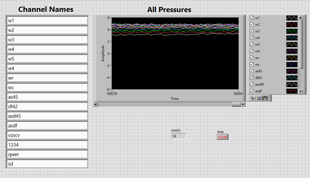

(4,339 Views)
It turns out that the legend height has become a problem, because it is showing inactive plots. I tried implementing your suggestions, but I must have read them wrong. Any idea what I am doing wrong?
(4,336 Views)
