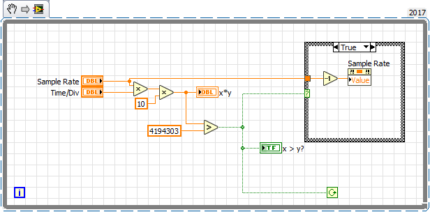

This works for what (I think) you want. However, there's got to be an easier way. I just can't think of one at the moment.
Message 4 of 25
(6,937 Views)
Maybe not the most elegant soultion but far better than the nothing I have come up with...
Thanks.

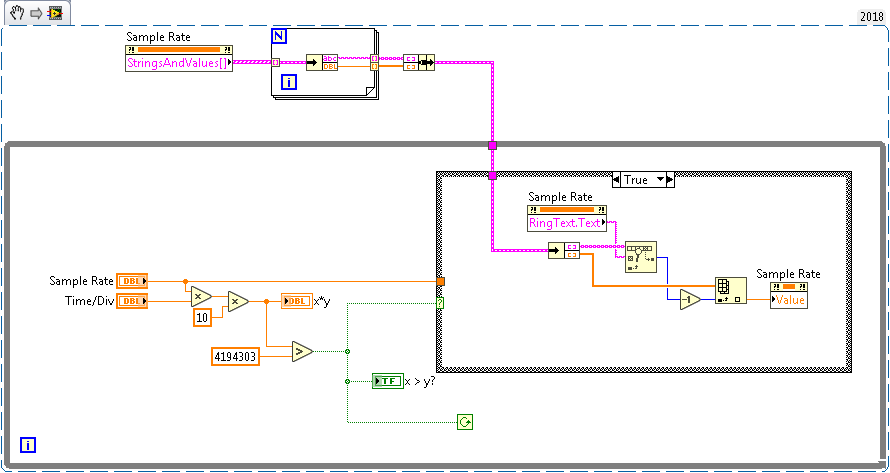

How about this?
mcduff
Message 7 of 25
(6,862 Views)
Close mc duff.
I would probably stick values and refnum of ring on a fbns, create cases init, close and coerce add error in out,
Init loads the fbns
Close dumps them,
Coerce handles the ugly lut. And throws a custom error if refnum is not a refnum too
Wrap each method in a sub vi.
And you have a nice lvlib with 3 public vis ,API, and a private core engine and ctl.
Elegant and reuse ready
