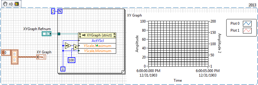

Assuming you have an XY Graph this little code demonstrates how to set the scales min and max programatically
(4,770 Views)
This is what I was looking for.  For a few hours I was trying to do this with the properties "Active Plot" and "Y axis Index".  Thanks to you I now know about "Active Y Scale"
