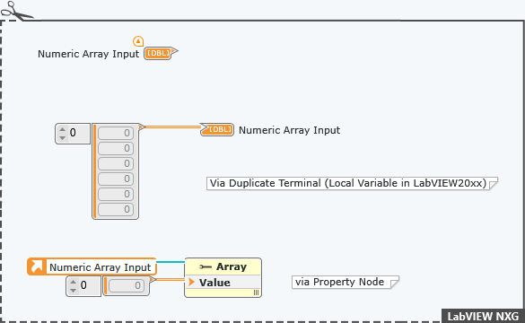

Two options:
(4,297 Views)
Just update the Array with Default Values(Empty Array) as soon as run Button is Clicked, Hope same works for LabVIEW NXG.

Thank you all for your help! I went with the property node and it works like a charm.
