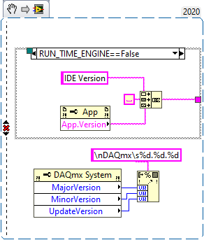

Would this work?

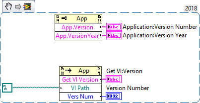

What is wrong with the VI Server methods?
The App properties retrieve the LabVIEW version.
The App method specifically works without loading the VI into memory so doesn't mess with a loaded VI hierarchy. The binary offset method definitely is not reliable. The VI resource file format is highly dynamic and you were simply lucky that it seemed to be always at that specific offset.

My thanks to McDuff and rolfk.  I (of course) knew my methods were a kludge, and was hoping for "better advice".  I haven't used VI Server for many years, so when I was searching, I overlooked these (and several other) possibilities.
I found it interesting that the Version Number returned by the Get VI Version method (Invoke Node) returns a U32 that, when interpreted as a Hexadecimal quantity, is 19008000, the same "human-readable" characters that appear in the second XML line of the LabVIEW Project File.
