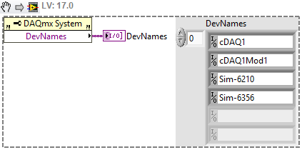

Hi sjn,
To get the available devices using DAQmx, you can use the DAQmx System property node and Device Names.
This can be found either via Measurement I/O > NI DAQmx > Advanced > System Setup > System Node or by dropping a Property Node and choosing the class via the right click menu (Select Class > DAQmx > DAQmx System).
I'd suggest making the device name an input to the system, and using something like Format to String to replace its usage in your configurations, if that's an amenable solution.

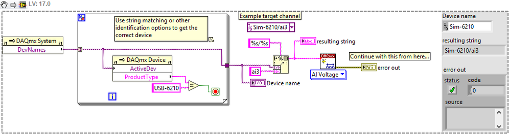

I would alternatively suggest the following style - you can do this as needed and avoid ever explicitly coding a device identifier:
I think that if you want to rename the device, you might need to go through the System Configuration VIs. The comment possibly worth making here is I'm not sure how you'd need to identify your device from the list - the name can be displayed but shouldn't be used programmatically, according to the Context Help, because it can change from version to version.
If you can uniquely identify with the available (and suitable) tools, that might be an option. The numeric part of the device name (e.g. 6210 in the above example) can be read, as can things like bus type, if simulated or not, number of slots...
Nice code, very similar to what I've written. Unfortunately doesn't handle these use cases yet
1) NI change the product name for essentially the same H/W (e.g. USB-6501 ; 6501-OEM) - but you might want to differentiate to that level. (Although I'm sure the product names have been changed in the H/W over the years with some H/W not having form factors in the product names until multiple form factors became available) It is possible to select by form factor and product number (but you need to verify with a physical device)
2) User plugs in more than 1 of correct device type
3) Have a physical device and a simulated device in MAX, simulated deice was created before physical device was plugged in.
The enhancement is basically to make the for loop conditionally indexing and then check the array size is correct for the desired number of devices on the system.
I do all this in an initialise DAQ function and store the array of cards cardnames in and FGV for indexing later and pre-pending onto the front of task names.
James
