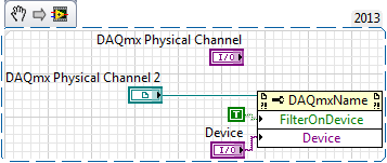

Programmatically filter array elements containing physical channels as controllers.
I have an array containing list of physical channel controllers. I want to filter the physical channels based in user inputs. For Ex: If the user selects Device 1, the physical channels should only display channels connecting to device 1. Currently the phsical channel array just displays all physical channels available. Is there a way to filter physical channels based on the selected device.

Use a FOR loop with a Search/Split String.  The "offset of match" will be -1 if the item was not found.  So use a conditional autoindexing tunnel to only include the items that were found (index >= 0).

I see that you have filtered out the channels based on Device selection, but I need the filetered out channels to be controllers, not indicators.
Users should be able to select custom channels from the filtered out list.

That's the hard way TimSmiley Wink
