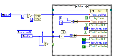

In summary, you should be able to do this if you find the properties Key Focus and text.Selection in 6.1. Checkout the screenshot!

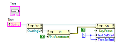

Small update: The owning vi (front panel) must also be the frontmost panel:
