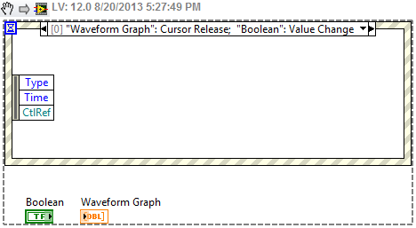

I currently accomplish this initialization using a structure below, and a value change event on the 'Init' Boolean:

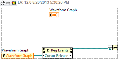

Where will your common code run? In the Event Structure? Could you just register for both events:
Or register the event separately to send it to the nested actor:

Hi Todd,
The code will run in the event structure. Thank you very much!! I didn't realize you could register multiple events to call the same code!
