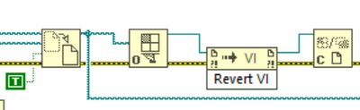

Hey Raphaël,
even though it's counterintuitive on the first sight, Revert VI is doing the trick. I added this to my script after copying the new files to the class folder overwriting the old VIs.
So what's happening here, is that Labview restores the new VIs to the state of the old VIs, since they were already in memory. Revert VI now restores the content of the new VIs, giving me what I want. I'll attach a modified, working version of the initial sample project, for future use, if somebody needs it. Thanks
