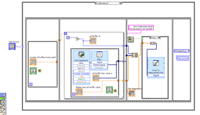

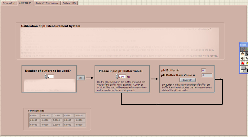

So far I've designed an interface that uses tabs:
And the block diagram:
The calibration part shown above seems to work. To describe the process... A flat sequence is inside a Tab Control. The first frame waits for the user to input the number of buffers. It then measures the sensor output with this buffer and also asks user to input the buffer value in pH terms. It repeats this using a FOR loop equal to the number of buffers input in the earlier step. Finally, in the last frame it displays these values in an array and asks the user if the data needs to be saved.
Once the calibration happens, I would like to switch the control back to the "PROCESS RUN" tab.

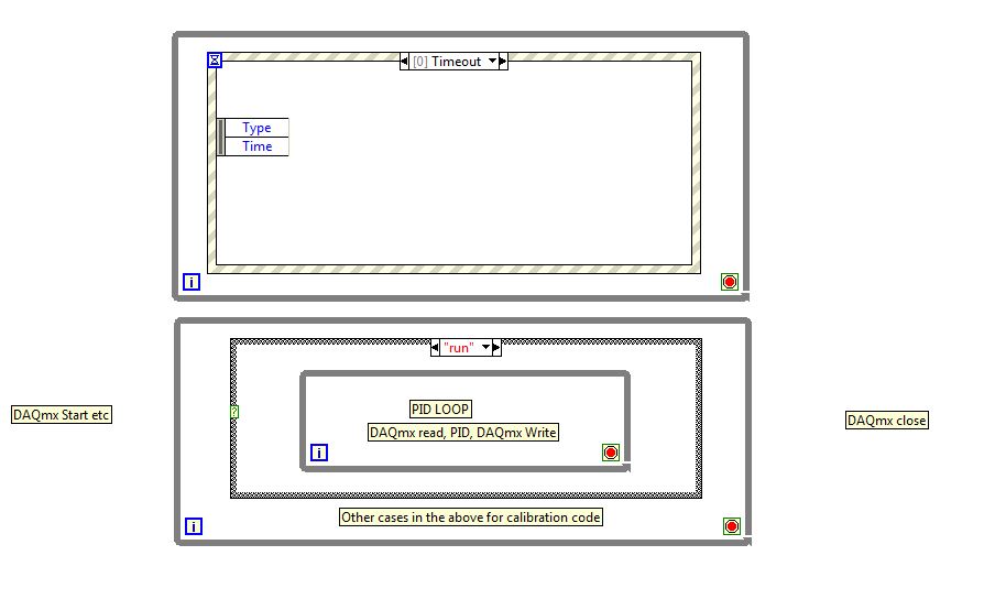

Hi Trog,
I would consider using the PID toolkit to control the motor.
The NI site has a good article on this, PID Theory Explained. .It shows how to use the VIs and how to implement it using the DAQmx VIs which you need to interact with the USB6008.
This image sums the design up,
But, for a more basic implementation you could replace the PID block with your own code - but it must perform its calculations quickly to give you a quick input to output response.
Then, as your design has several states (calibration.. running..) I would suggest using an event based architecture. Where the above loops goes within the running state.
For a more detailed reference I would suggest looking in the NI Community site. This is a good starting point,
Sending Data from Consumer to Producer Loop with User Events.

4. Should I be using Flat Sequences like the way I'm doing it right now? There is nothing wrong with using sequence strucutres - IF the code must execute in order. Normally you can enforce data flow using the error clusters, but not everything has them. WARNING labview is very parallel, thus very powerful. If your whole application was in a sequence structure then it maybe wouldn't be as parallel as it could be. I.E two loops in labview can run at the same time, but not if one loop was in the first frame, and the second in the second frame. IN YOUR CASE, it does appear that you need to get user inputs first ( I would maybe use an event called start, run and save. I would replace the frames in the sequence with states in the case structure.

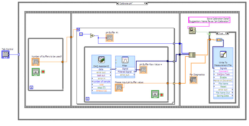

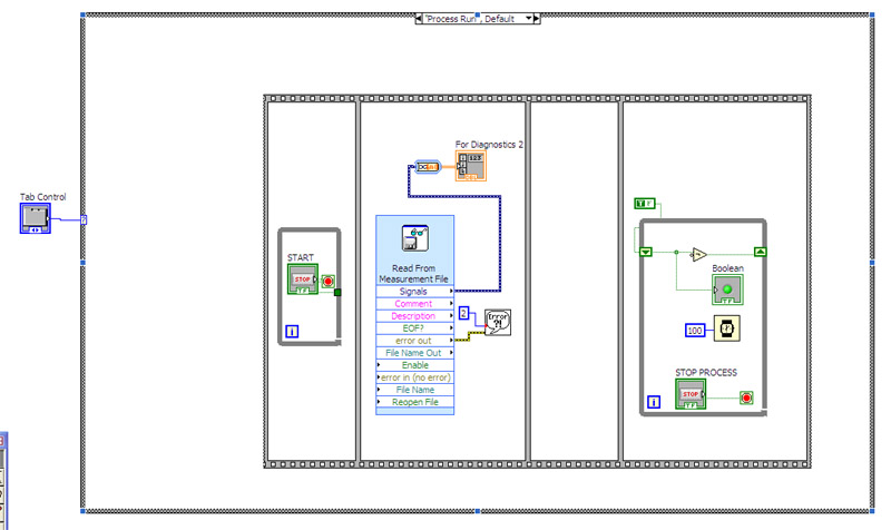

Continuing after modifying and reprogramming...I've another problem:
Lets say the vi front panel has the first tab highlighted. I run the program with front panel showing this tab, and it works. However while this tab is active running, if I click on another tab, the vi on that tab won't work.
Similarly, if the second tab has a vi running, then on pressing the first tab, the vi in the first does not run.
Kindly have a look at the vis (block diagram) and let me know how to let tabs run even while switching between tabs.
 BLOCK DIAGRAM FOR FIRST CASE
 BLOCK DIAGRAM FOR SECOND CASE
Once again, let me know how to let tabs run even while switching between tabs.
Trog.

I would recommend that you consider using a producer/consumer architecture (which is effectively what Hillman was suggesting) for your overall application architecture. You should also consider using a state machine for your process controll. It is much more flexible than your current structure of fixed cases with embedded sequence structures. In general you should avoid using sequence structures in LabVIEW applications. Embrace the power that data flow programming provides. Over use of sequence structures is akin to forcing square pegs into round holes.

Use an Event structure inside of a state machine .  Please see the attached example.  Extract the llb into a directory, put the configuration file in the same directory and change its extension to "dvs".  Otherwise when you start the top level VI, "HMI Data Viewer Main.vi", it will tell you the configuration file is invalid.  Or you can just OK the error box and then browse to wherever the configuration file is.
In the Event structure you could detect TAB control changes and then load up a series of states to execute.  In the attached example, this occurs in the "User" case.  However, it does not have a TAB control.  Let me know if you have any questions.
