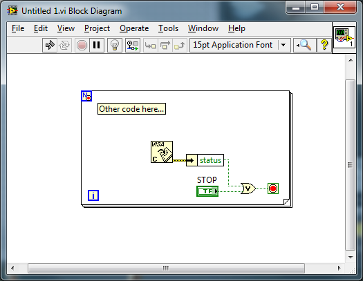

Nope.  The stop button can and probably will be read early in the loop iteration.  Only the boolean OR and feeding of that to the stop terminal will wait on the rest of the code.

Sorry, but you are going to have to use a sequence structure.  That's why they are there.  They do have their purposes occasionally.  Here's how I would handle it.

No.  Don't use a stacked sequence.  It hides code.  You can see from Crossrulz's picture that the flat seqence won't take that much space.

Oh yeah, I forgot about being able to use the error status as an entry tunnel to the flat sequence with a single frame. That should work. That's what I was looking for! Thanks!
