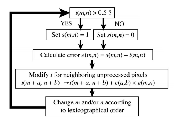

A nice view of a block diagram of it is this:

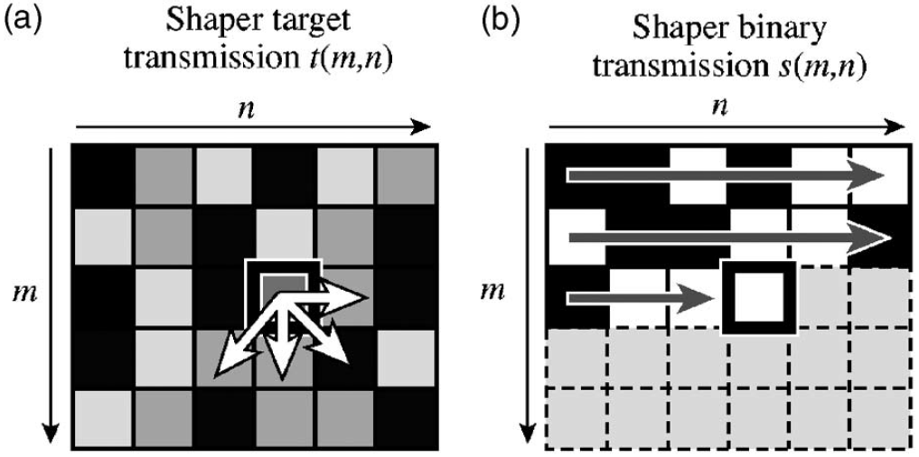

The reflection t(m,n with m,n being the coordinates of the system) is rounded to either a 0 or a 1. The value that is actually assigned is called s(m,n). The difference between these two is the error e(m,n). The unprocessed pixels are these:
I am having trouble with the diffusion of the error to the neighbouring pixels, so the most important part. I tried adding this to my algorithm but failed.
My attempt included separating the coordinates from the image and adding numbers to them.
I did this as following:
I seperated the coordinates and splitted these into the X and Y values. I then copied this data four times for four  neighbouring pixels. These were x+1,y and x,y+1 and x+1,y+1 and x-1,y+1.
I however had trouble combining the error with the calculated value when I actually get to those pixels. I can't get to add the error to the pixel that is for an example underneath it. Has anyone any idea who I can add the error to these neighbouring pixels?

Dear Jos,
I have already succeeded. I used case structures and logical operators to determine whether or not a pixel was at the edges. Then I filled an empty array with these errors and later on retrieved the error per pixel. But thank you for the offer!
