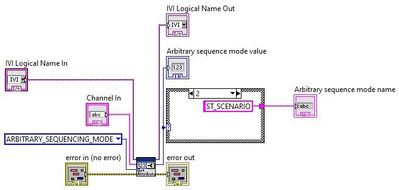

Yes, you're right. I forgot to attach anything. Here you can see my initial code. In the input, in the attribute ID/name, I can choose between many attributes (here, arbitrary sequence mode). In the output, I'm basically getting the name and ID of each mode. (for instance, ST_SCENARIO mode's value is 2). However, if I follow this approach, either I need to write many separate VIs for each attribute or write a big VI with a case structure. As a solution, I was thinking about a better approach, that's why I was thinking about the property node. However, I'm not sure if it is a good choice or should I do implement my program in another way. Thanks

As you can see in the attachment, this is a very basic code I've developed. I'm querying "arb seq mode" here and outputting the relevant sequence and its ID. As I said before, I can query many attributes; so if I want to develop a program for all attributes, either I should write many similar VIs or write a big VI with a case structure (I think). To make my programming more efficient, I was thinking about the property node. Not sure that will help though!

I would create one Vi with a case for every arbitrary sequence mode value.
Also make the Arbitrary sequencing mode a control.

Great, thanks. That helped. I created another case to manage each attribute right after the input (attached). I think it is fine however the downside is each case is returning a specific value, like the example in snapshot "1150049". For future troubleshooting, it might be a pain but I guess I can add a note inside each case; for instance, 1150049 > arbitrary sequence mode and so on. Do you agree with this setup?
Note: the reason I put the output indicator inside the case not outside, is basically each attribute has its own output, so I am working on it to make it look better. haven't found any solution yet though.

If the input lookup enum in is arbitrary sequence mode cast the integer value to a strictly typed ring of arb sequence modes.
As far as documenting a case structure driven by an enum..... try wiring an enum type to a case selector..... then smile.

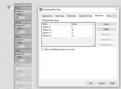

Hello again, can anyone please advise how to create an enum from the ring? following up on the previous post, it makes my job easier then I can create a case for each enum item quickly. With the ring, it's a very time-consuming job. Thanks
Message 9 of 12
(3,236 Views)
I suspect the problem you will have is that your ring values are probably not sequential. That is, they have strings and values like this one:
You can create an enum with the same strings (provided they are unique) but you can't match the values unless they're sequential (or you put in a lot of dummy values - but don't do this if it's more than one or two).
Then you'd need a way to map between them - you could do this with subVIs each way, but it seems likely to be about the same amount of work? (The upside is that you might be able to make use of it repeatedly, and it might make handling easier later - you'd do all the work building the subVIs "up-front" (or at least for the ring values you cared about) and then nevermind, this is definitely scriptable...
