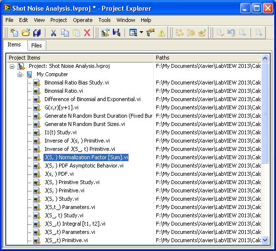

Let's start with a snapshot of the project content:
Notice the selected VI. It has a small "s" variable name in it. I'd like it to be capital S like all other VIs. Also take a look at the VI called J(S, ) PDF.vi below it. The letter is capital S.
Now I right-click the selected VI and chose: Rename

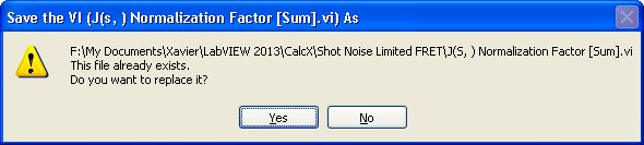

I get an Explorer dialog window where I change the name to "J(S, ) Normalization Factor [Sum].vi" and after the following warning dialog:

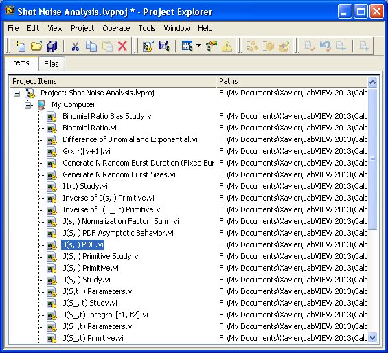

I press OK and contemplate with satisfaction the new project explorer window:
Amazing feats of modern technology!
But wait! What about J(s, ) PDF.vi? Why has it switched to a small "s"?
After almost 20 years of LV, I have stopped asking questions like this, so I just go ahead and am about to rename it to J(S, ) PDF.vi...but hold on a second... What the????

Message 1 of 11
I don't see any OK button...

Oopss. Obviously I am using LV 2012... There must have been a typo in that folder name ;-(
 There is none. The correct action is to press "Yes" (the explorer doesn't distinguish between cases).
