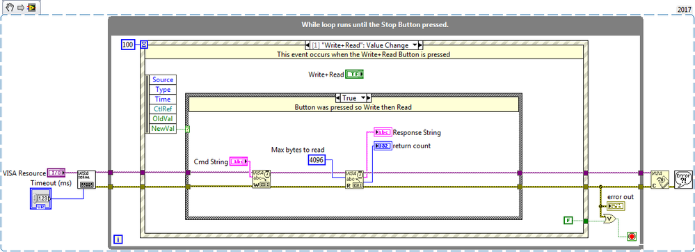

You need to use an event case to wait for the button press, then write, then read. The way it is set up now it is spending most of its time just sitting there waiting for the read to timeout.

You probably want to use an Event Structure at the least and possibly a State Machine if you want to extend it further.
#1 - As it is your loop is running flat out hogging resources and trying to read from device on every iteration.
#2 - Obligatory: Don't use Bytes at Port!
A simple setup with Event structure would be as follows.
Edit: Had stop button in wrong case.

08-09-2018 05:09 PM - edited 08-09-2018 05:31 PM
- Edit- Cstorey thanks for the example.
The problem now is that I can read data as fast as the button press event lasts. I'd have to click the button multiple times to read all lines of data. I've tried putting Waits inside the loops but I think it's causing an overrun error. The button mechanical action is latch until release.

Bob's advice is good, look at changing the termination characters and see if you can read the entire response. If that doesn't work, then do the the read in a while loop. As long as there are characters being returned by the read, keep reading until there are no characters returned.
