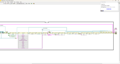

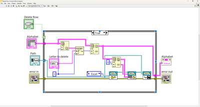

I'm trying to implement a function where the user can delete a row of data from an Excel table. I made a very simplified example to show the problem I have. Here's the block diagram for it.

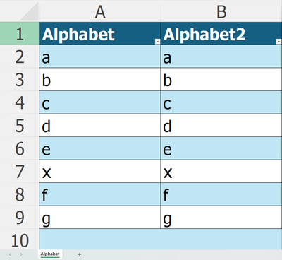

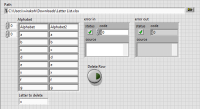

Say, for example, this is the data I have, and I want to get rid of the x.
Using RGT, I read the data from the table into an array.

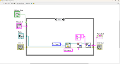

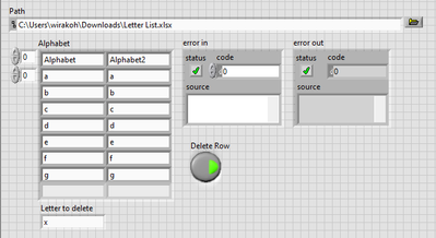

Then I activate the row delete function, and it deletes the row from my array

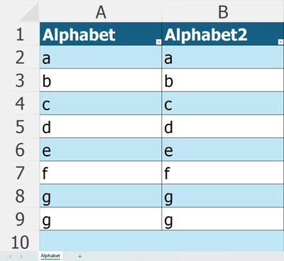

The problem is, the "Append Table to Report.vi" only changes cells in the Excel file that are affected by the new table. Because the array has 1 row less now, the last row in the previous Excel file doesn't get changed or deleted, so the "g" in row 9 of the Excel file stays there.
And if I load the Excel table into the LabView array again, the "g" row gets doubled.
Furthermore, if I want to delete the last row on the table, It simply won't get deleted because the new array doesn't change that last row.

Alright, I just finished trying something out
I ended up creating this monstrosity, which somewhat works I guess.
Also thank you to aputman for the tip on using the Excel Insert Cells.vi as reference, which I wish I read before making this thing.
Cheers, Hubi

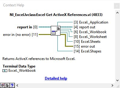

Make use of the Get_ActiveX_References.  It simplifies a lot of the work.

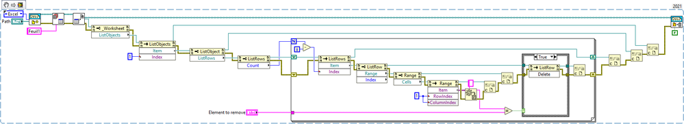

As said, use Excel Get ActiveX reference to simplify the code. The way you implemented your code the last row of the table will always be deleted. You need to look at the content of each row to see if there is an "x". I attached an example of a possible way to do it. Note that I start with the last row of the table because if you start with the first and delete a row the index of the last row will change. I only use the content of the first column for the comparison, you can easily modify the code if you need to compare both columns.
